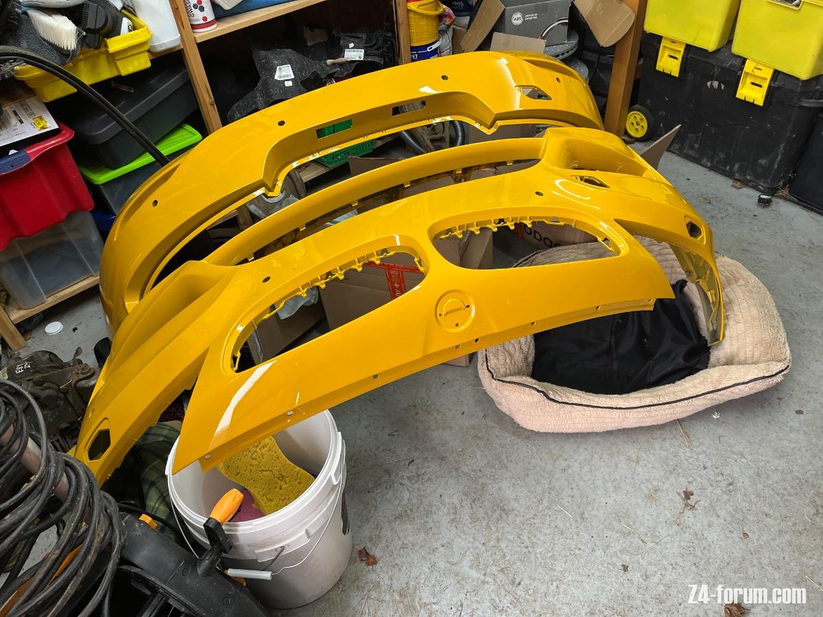

Bumpers back from my paint man…’donkey punch’ removed from rear bumper..he used 2k industrial primer before 2k top coat and 2k lacquer..
Extra lacquer coat on rear diffuser (not shown)..to help stop the gravel rash on hooks..
He reported the front bumper had been repaired and painted badly at least twice…you never really know the history of a second hand car..

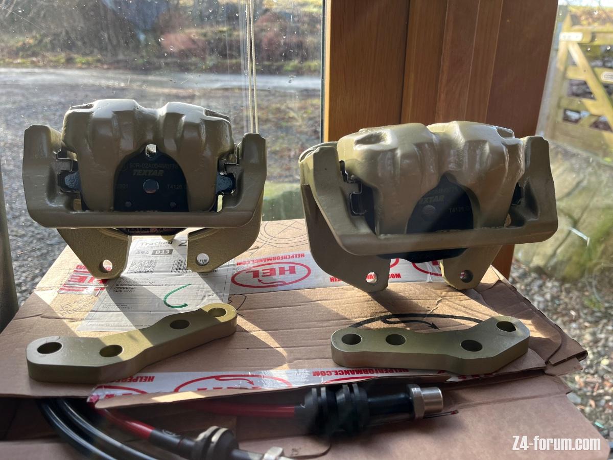

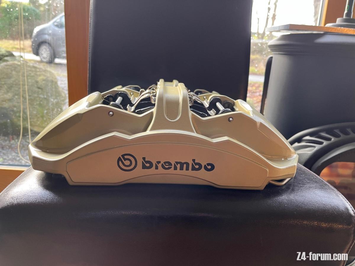

Plan for world domination goes slowly…
Managed to sort out a lower cost brake pad spring clip…Ford wanted 400 USD for 2 sets of clips n pins…used some pattern BMW M8 Brembo caliper pins….so assembled the front calipers…M5 rears now painted ready to be rebuilt with new seals n pistons..
Awaiting a much delayed set of bolts from USA ..7 weeks and counting..plus M5 rear dust shields on back order..

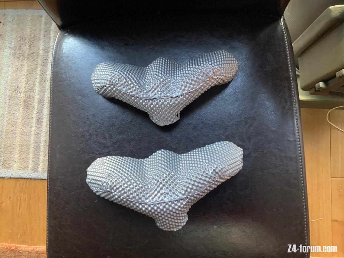

Free Cadburys Cream Egg to the first person who can guess what these are in less than 3 iterations..winner must collect from a Z4 Owners Scotland run or meet..

B21 wrote: Wed Feb 05, 2025 5:43 pm Free Cadburys Cream Egg to the first person who can guess what these are in less than 3 iterations..winner must collect from a Z4 Owners Scotland run or meet..
Handlebars for a wee tyke's scooter?
Chastity belt :thumbsdown:

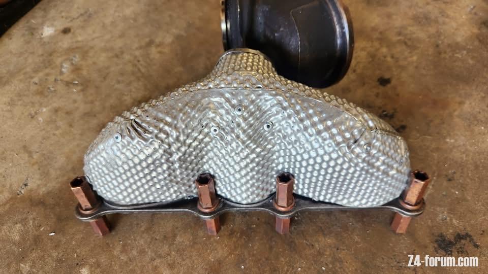

B21 wrote: Wed Feb 05, 2025 5:43 pm guess what these are in less than 3 iterations
There's three entrypoints into one exit point, twice. You have a six cylinder engine, which matches. Shielding for exhaust manifolds?
They do look a bit VR Headset meets industrial requirements though.

2nd version of 3D printed rear brake adaptor bracket arrived to allow 370mm rear discs to be fitted to E89s..
Production version of the 345mm bracket for rear disc E89 in a fetching gold colour..
Both using a 5 series (F and M) rear caliper
One of 258 Atacama Yellow 35is…165 modifications and updates…and counting.. :tumbleweed:

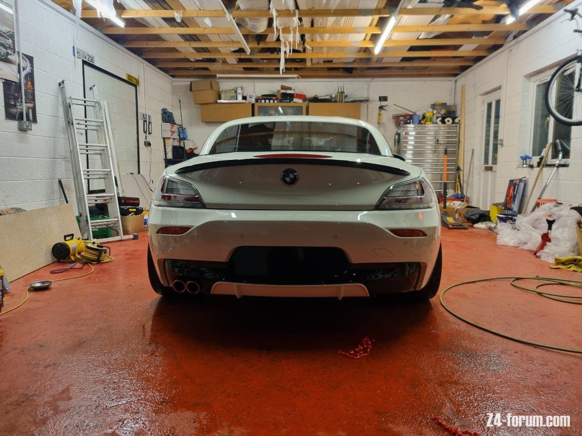

So, tonight I fitted my new m sport rear bumper along with a boot spoiler and new rear badge, then gave it a 2 stage machine cut and polish. Really happy with how it's turning out now.
