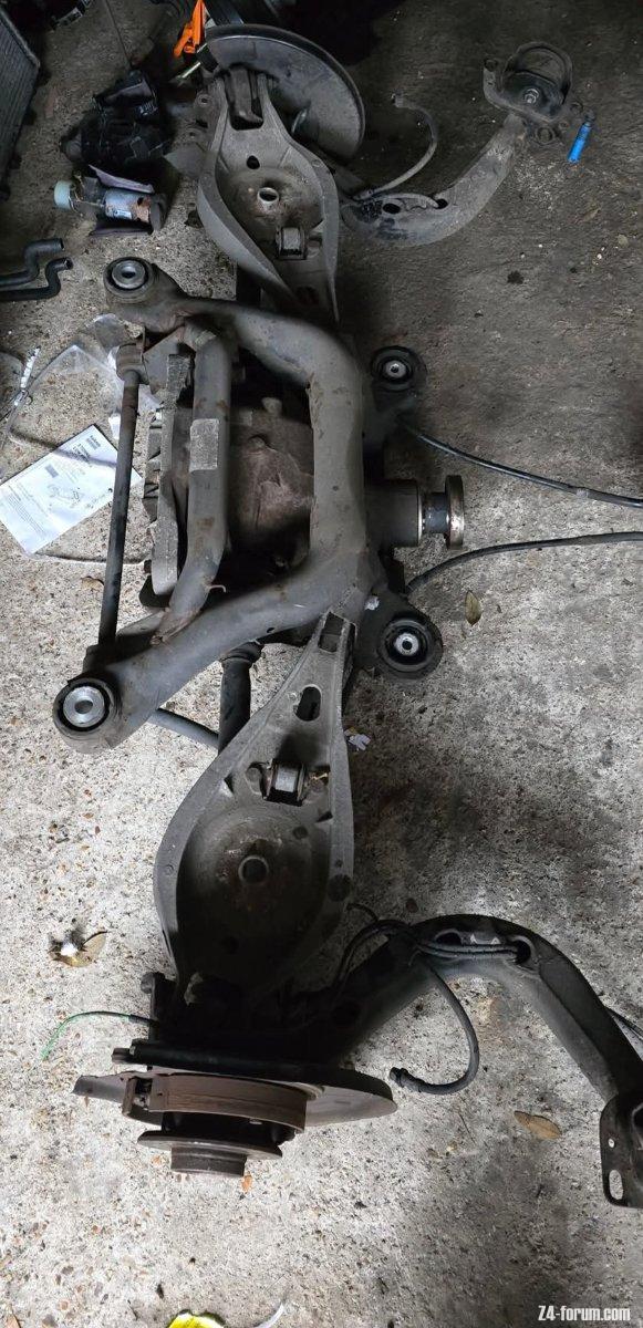

Removed from a 2006 z4mr with 111k miles
Subframe, arms, shafts and diff, all in good working order
Rear trailing arm bushes are black series powerflex
£1400
Collection from southampton
SOLD Z4M complete rear end £1400

I tried searching but got somewhat confused - anyone know if this would bolt up to a 3.0si happily or does it require other bits changing? Possibly the prop shaft length needs altering and the brakes would differ?

Propshafts are different lengths by the looks of it, so I doubt it'd be a direct bolt on from what's on sale above, sadly.
3.0si: 1181mm or 1223mm (auto/manual) https://www.realoem.com/bmw/enUS/showpa ... Id=26_0229
Z4M: 1170mm https://www.realoem.com/bmw/enUS/showpa ... Id=26_0230

I can confirm it's not straightforward, primarily due to driveshaft length differences (as mentioned above) and the need for custom propshaft due to flange and length differences...not impossible but could be costly.

Figured it wouldn't be simple or folks would've done it before and talked about it. Thanks both
