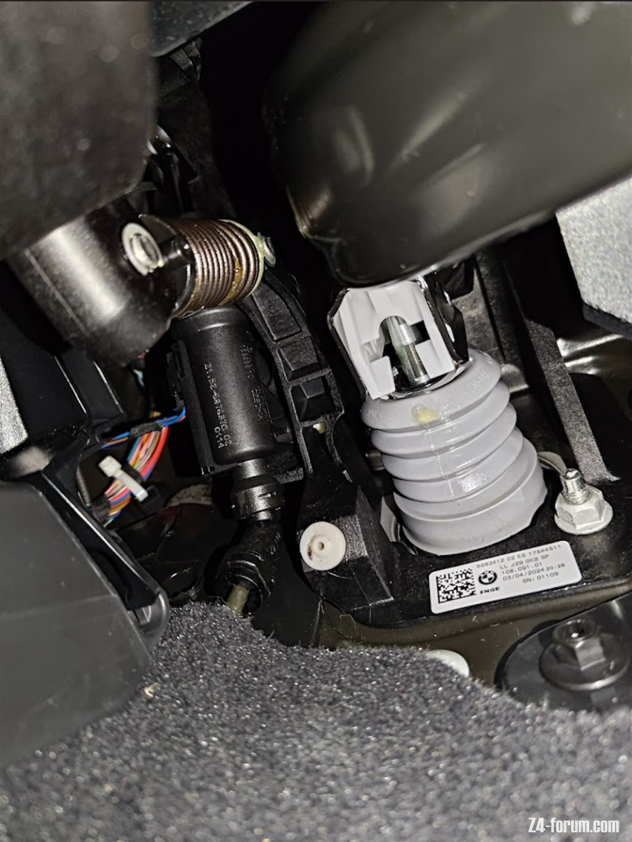

Any chance you have a photo of what the sensor looks like? I tried my best to snap a photo of the brake pedal connections with my phone. See below:BMW Bros wrote: Sun Oct 20, 2024 1:28 am Fixed!!!

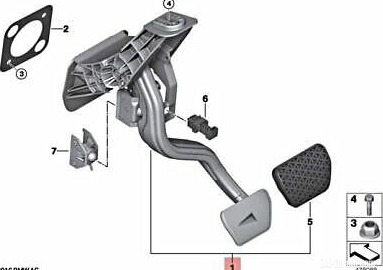

Hello EECOOG -
I do not have a picture, but I did do a quick internet search and found the below diagram which is similar to the layout/construction.
My advice would be to remove the kick panel cover and follow the brake pedal to where you find the first sensor / wire connection, maybe half way up the brake pedal stalk.
