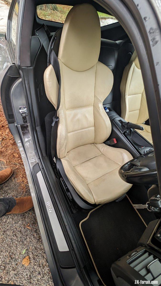

Regarding the seats, are you concerned more about the seat base rather than the bolsters on the seat back?
The drivers bolster, from what little we can see, actually looks quite good.
The drivers seat base however, could be from the angle slight fish eye effect, looks like it needs some extra padding. Now with the seats not being heated this makes the task a little easier because the heat pads on the sides are normally stuck to the foam. You won't have those and so you can stick some padded material onto the foam. It won't need to be very thick to make the difference. 3mm thick over the side foams will pull that leather tight again.

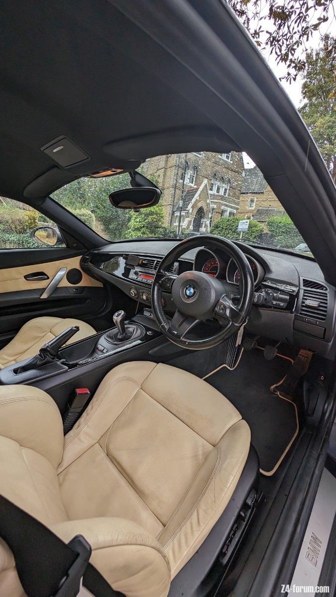

Morning gents - photos of the seat in question. I just think it needs a bit of TLC.

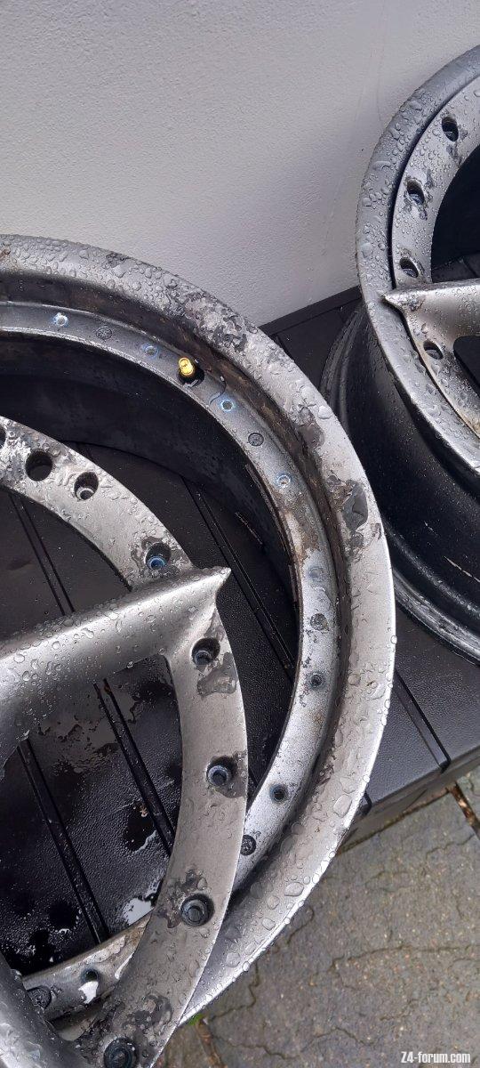

With regards the alloys, they are all like this. Inner piece looks ok but outer rims are corroded and/or kerbed. Not sure if they are polished or painted. I'm not looking for perfection, will a company leave the 2 pieces bolted together and just repair and respray the outer piece (assuming they are already sprayed?)

Post by raymond.harper » Wed Apr 03, 2024 9:36 am
You can paint them without splitting the rims but it would be a bodge job. Corrosion could occur around the bolt holes

From my experience with split rims, a lot of wheel refurbishers won't touch them as they a lot of hassle, and if they do it's expensive. I had a set on my Jag, I ended up getting them sprayed, but it's a bodge, not as good as powder coating and then the bolts on one wheel started exploding! I would keep an eye out for a good second hand set of alloys, always someone on here selling something. :thumbsup:
