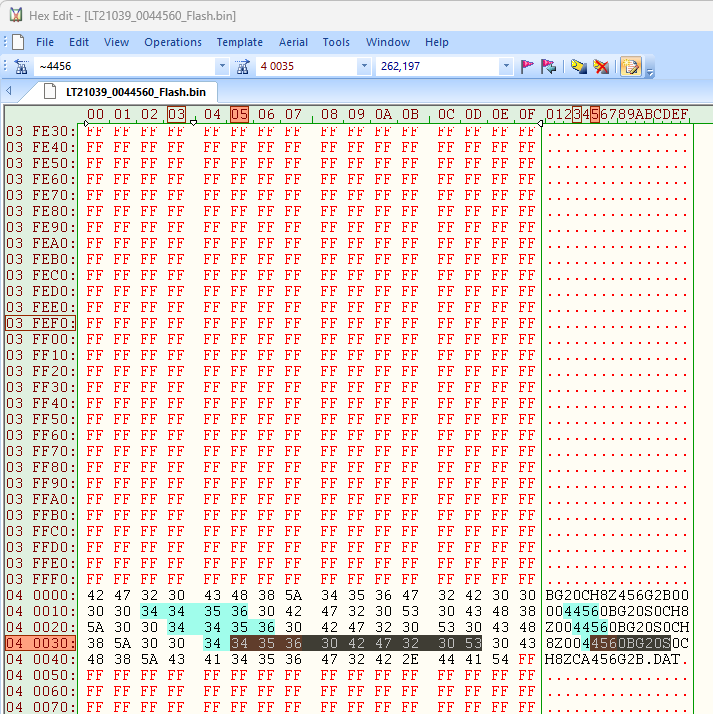

Yeah, the the software that is on your ECU is 456BG23S.
Attached is an XDF with the rev limiters for your software version (assuming you're 6 MT)

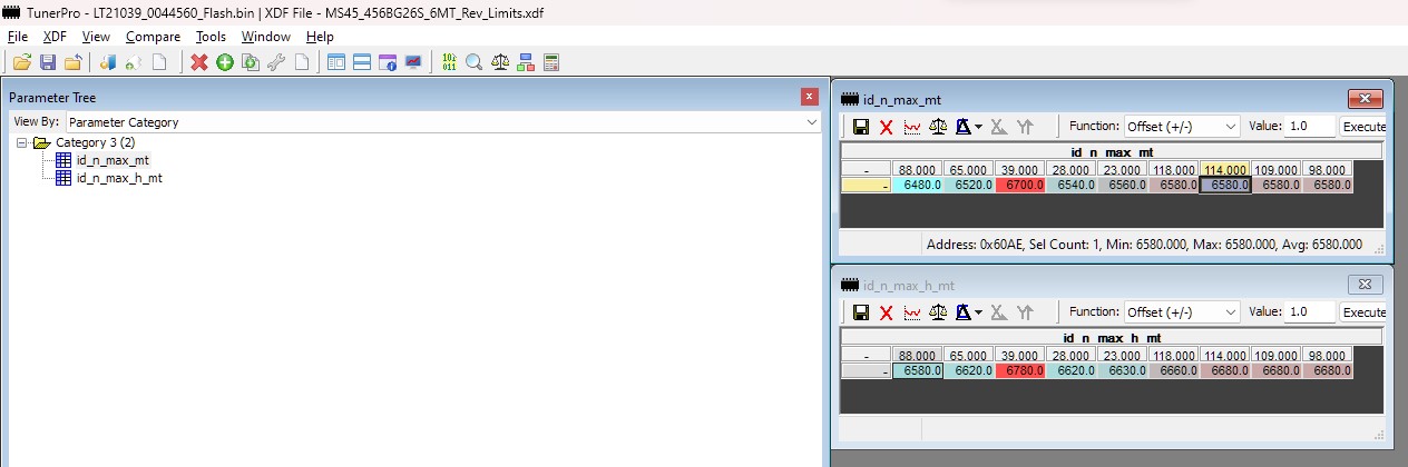

I’m using hexedit as per the screenshot. TunerPro is what you load the XDF into.
I suspect the version the Z4 uses/is on your car is already on a later version than the original XDF was created from as the XDF looks to have been created from a leaked A2L/Damos.

I know the second row is the RPM limit at various points but what is the first row and what do the different columns mean? Is it a limiter by gear system?
To raise the limit by 500 rpm do I increase all the numbers by 500?
Also, how do you make the limiter more aggressive? I know for ms43 you reduce the limiter hysteresis in c_n_max_hys but is there something like that for ms45?
