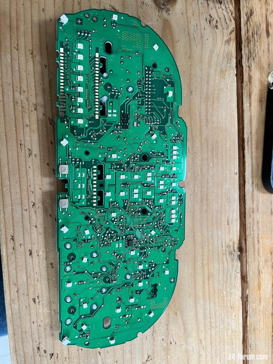

Post by bigwinn » Sat Mar 18, 2023 8:39 pm
Zulu4 wrote: Sat Mar 18, 2023 8:27 pm Very interesting. Well done Stuart :thumbsup:
Could you point out which chip is the eeprom in question.
This one- on the rear of the side you open the cluster up to
