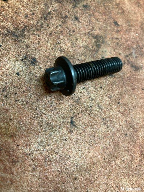

I don’t suppose anyone knows the part number or where I can find a new replacement bolt? My mechanic thankfully got mine to move but as the head is worn a little I’d like to replace it with a new one ASAP.
Thanks.

Someone was using an 8mm ratchet spanner to undo the torx bolts on the steering as it would fit and made it easier, I have looked on line but prices vary from around £5.00 up to £20.00. Reviews show the cheaper ones falling apart and the Wera one £18.00 also, what make do others on here use please. Thank you. :thumbsup:

MikeyH wrote: Fri Mar 03, 2023 7:58 pm Someone was using an 8mm ratchet spanner to undo the torx bolts on the steering as it would fit and made it easier, I have looked on line but prices vary from around £5.00 up to £20.00. Reviews show the cheaper ones falling apart and the Wera one £18.00 also, what make do others on here use please. Thank you. :thumbsup:
T'was I!
Mine is from a Halfords Professional set and seems to work perfectly well. :thumbsup:

poortomsacold wrote: Wed Mar 01, 2023 8:49 pm I don’t suppose anyone knows the part number or where I can find a new replacement bolt? My mechanic thankfully got mine to move but as the head is worn a little I’d like to replace it with a new one ASAP.
Thanks.
Tom,
I saved one off the breaker.
It'll be in the bag of bolts I send you with all those panels.
I'll wrap a bit of tape round it so you can find it easily.

enuff_zed wrote: Fri Mar 03, 2023 8:42 pm
T'was I!
Thank you enuff_zed I don’t want it breaking half way through the job :D

The ones I’ve done have not been too tight once you get the initial bit of a turn on them. You can hook another ring spanner over the end of the 8mm one to give more leverage to break the initial stiction
