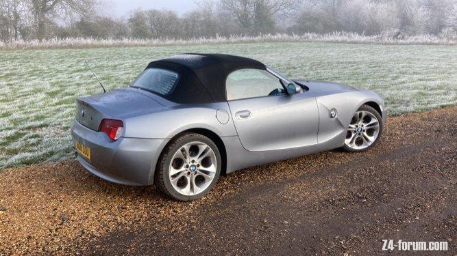

I had a post on here a while back about my wheels, when I first bought my Z4. Something I didn’t notice when buying the car was that I have one odd wheel! If I remember the models correctly I have 3 x style 202’s and an odd style 107 on the rear! I’ve beeb hunting for a spare rear style 202 for about 6 months and can’t find one anywhere. Getting to the point I might be better replacing the full set. But struggling to find a staggered set in the correct sizes. Does it make that much difference if they are staggered, e.g. rears are 0.5” wider? There seems to be much more option if I went for a non staggered set?

You rarely see 202s for sale. 107s are more common and a nicer looking wheel IMO.
It’s not necessary to run a staggered set. Although all the 18” wheel options offered as OEM options on the Z4 were staggered, the 17” and 16” wheels which were offered as standard on most models where square (8J x 17”, 7J x 16” all round).

there should be loads of staggered sets on ebay and the like, you've got 107s, 108s, and 202s as standard Z4 wheels... then any 18" wheels off a E46 3 series will fit, and even 18" wheels off an E90 3 series.
of those wheels, a staggered set of MV1s is probably cheapest, but MV2s are easy to come by too, and MV3s looks good and have a slightly lower offset so fill the arches slightly more.

As has been said all the OE 18" wheel options for E85/86s and E46 3 Series were staggered.
But I have had a couple of sets of Replica wheels that were 8J x 18 all round.
I fitted a set of E89 wheels to my 2nd Coupe that were also staggered 18s, but thanks to the different offsets they sat much further out in the wheel-arches so E89 wheels may be another option.
