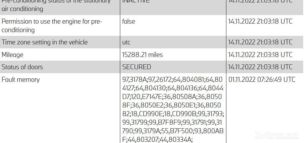

Post by Menacing » Wed Nov 16, 2022 6:51 pm
ori wrote: Thu Nov 10, 2022 5:49 pm I had this on my previous e89 when it was just a few months old. It showed up as an error on Carly and requires a new door handle.
Do you have access to a code reader like Carly?
I tried the code reader and nothing like it came up.
I did the BMW "Request data archive" and it had quite a few errors.
Amongst others:
64,804127 front passenger door
64,804130 Outside door handle electronics
64,804136 Central locking system rocker switch in front passenger door
via https://bmwfault.codes/
I have it booked in.
Thank you for your help.
Menacing
Newbie
Newbie
Posts: 7
Joined: Sun Feb 09, 2020 11:21 pm
Comfort access
Post by Menacing » Tue Jan 03, 2023 6:20 pm
New door handle fitted, all is good. Thank you.
