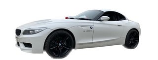

Gave it a treat to compliment the black wheels.
Link here
https://www.ebay.co.uk/itm/363090045430 ... media=COPY
First class service and fit is spot on.
Link here
