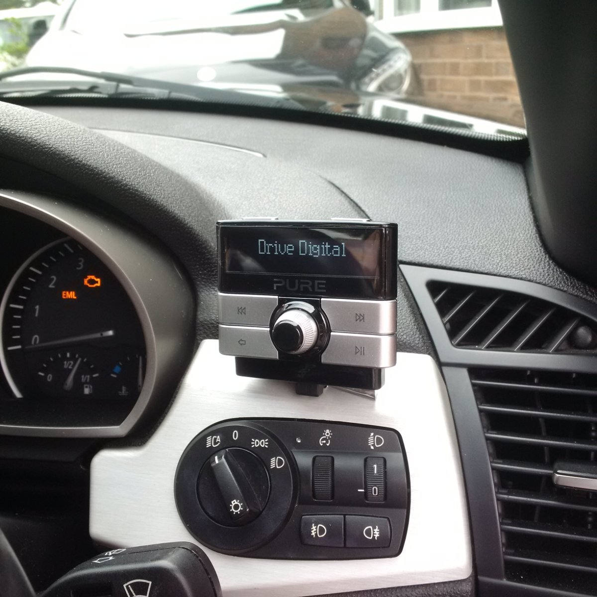

The model I installed was the 300di, as in the ebay link in the post above from AnilS. So there may be differences I'm unaware of, but my antenna looks like this... The mistake I made was mounting it too high up the screen and onto the black strip - it needs to be about 10mm lower and off the black. The 'base' of the antenna (black box bit) stopped the windscreen headrail trim being replaced so I had to cut out a small section of the trim. Impossible to see, but annoying that I made the mistakeTommo61 wrote: Wed Sep 11, 2019 8:47 am do you have any pictures of the antenna/usb/aux positioning and cabling, and did you use the magnetic grounding tail? I've got one (Highway 400) in a box ready to install as they were going cheap on amazon and I've been impressed using one in another car.
I was planning on putting the remote right there too!![]()
I was going to place the USB in or near the removable panel below the heater controls, by the aux socket, and even bought the right type of lead/surface mount socket - but in the end I just used the supplied lead and left it hanging in the glove box (easier to fit, and a 16GB memory stick lasts a loonnng time).
I've no pictures of the cabling, and it's all out of sight now
For mounting the controller I didn't want to drill the dash and neither did I want to use the sticky pad option. So I obtained a spare piece of aluminium dash trim (so to return car to stock in future maybe) and cut a section out of it at the top for the cable to pass through; using tin snips and a section of chromed steel sheet (cos we've all got some of that at the back of the garage
EDIT: just found a photo I took of the brainbox in situ, before being wired up. Taken from where the glovebox would be, the photo was handy to look at when trying to identify which socket is which once all the cables were in the way.

I think I've covered this in the last post aboveAnilS wrote: Wed Sep 04, 2019 9:43 pm https://www.ebay.co.uk/itm/Pure-Highway ... 1438.l2649
Was it difficult to hard wire in and did you have to drill into the dash?
The one thing I will say is that the user instructions refer to this as being for professional installation (don't understand why) and don't give installation instructions. For those instructions you need to go here https://support-uk.pure.com/en/downloads/manual-13
You'll also need the correct harness adapter to connect to the stereo, so I'd suggest you give Dynamic Sounds a call and tell them what you've got and they'll sort you out for a few quid.
All in, to fit the same as I have you will need to remove: glovebox; sun visors and headrail trim; A-pillar trim; side vent; central vents and stereo; LCM dash trim; and, dash panel above ash tray. Depends on how you want to mount the controller, but I did not have to do any drilling into anything - or splicing or soldering - other, of course, than the cutting of the dash trim around the lightswitch, as described in previous post.
The only downside of my installation is that I think I may not have full functionality, in respect of how long the tuner stays on. The advert/manual refers to it staying on for a period after the car is turned off, but is a bit vague about this. Mine doesn't, and it also spends 30 seconds retuning every time I get in the car - although it does remember the programmed favourite stations. I think it's possibly because I didn't connect some further power cables, but I couldn't be bothered figuring out where to splice in to, so just went with the plug and play functionality. Also as a weekend-only car, I didn't want anything with the potential to drain the battery. At the end of the day it works and I'm happy!
