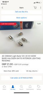

I did this on my MR just 2 weeks ago. Yes, you can totally do this yourself although I think tou should just go and collect your car for now and re-do the MOT when you are done. This is because you need to order the bulbs and then tou can change both.
Installation video:
https://youtu.be/HhJTkCQk7HQ
The guide on this page is what i followed and you will kick yourself at how easy it is once done.
I also add the bulbs I replaced the stock ones with they are 20w and have caused no issues whatsoever (stock are 10w)
Goodluck
Goodluck
- 1711C351-7B40-4627-8CB9-74859E73B851.png (256.96 KiB) Viewed 1732 times
