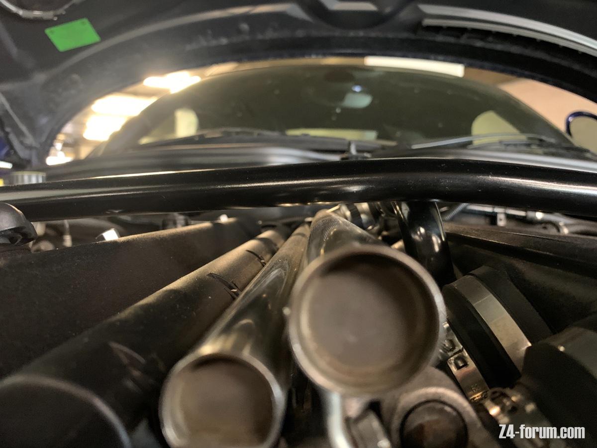

Maybe not but again are we talking anything evidential or just musings? My point is that non-evidential / hypothetical information isn't very useful, anyone can assume that something might or might not be the case but without anything to back it up it's not that useful as 'information'.
I'm not particularly defending the M3 strut, I'd happily take it off if there's reason to, I'm not affiliated with it in any way! :lol: I could happily sell it for what I brought it for so I've no reason to defend it, just passing on my actual experience with it so far which is the camber bolt needs removing and it slightly touches on the bonnet above one of the strut mountings.
I would agree though if Rvs said his was touching or close to it then I guess mileage can vary, seems odd though, should all fit the same. Maybe it was damaged, not fitted correctly, who knows, I'm not convinced it's engine mount related though. I think it's fair to say it's an imperfect solution but not unusable either.
Just as a reference point this is mine as fitted re: clearance
Where to source strut brace
Posted: Wed Sep 15, 2021 4:27 pm
by Jon2215
Reference Andys picture with the clearance,mines the same with the M3 brace,just about get my finger between the rail and brace.
