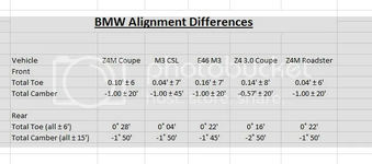

Car is completely OEM in terms of suspension and wheels. Can anyone do me a solid and suggest a good set of parameters (camber, toe, caster) I can tell an alignment shop to follow and apply?

more importantly than what settings to go for, make sure you take it to an alignment place that knows what they are doing! a full 4 wheel alignment is about £120 round these parts, thats how much i'd expect a decent place to charge.

That doesn't look right, not enough front camber, use this one
http://www.clubcsl.com/CSL/various/whee ... entcsl.jpg
And yes ask somewhere competent to get you close to that, bmw will do it if you ask the right person nicely

Just to confirm, these alignment numbers from the csl be obtained with stock z4m suspension?
In what way will the car perform differently with these settings?

Indeed if you pull the camber pins on the front.Z4MCoupe86 wrote: ↑Mon Sep 06, 2021 1:10 pm Just to confirm, these alignment numbers from the csl be obtained with stock z4m suspension?
Less understeer, more balance, bit more darty on the front end but as a downside more tramlining.
