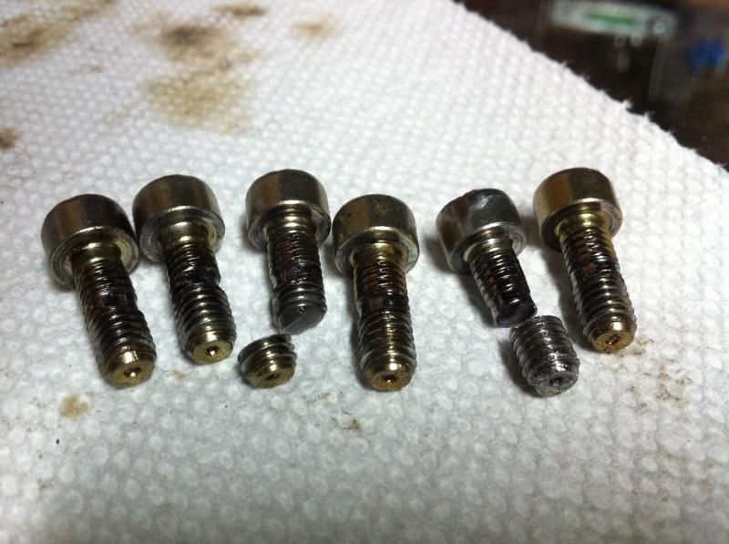

I did everything above except the "Beisan Systems S54 Vanos Rebuilt Solenoid Coil Pack (BS023)", which can be replaced when it fails since you can access it pretty easily. The engine is as smooth and quiet as a sewing machine now - no more "marble in a can" rattles at around 2.8k RPM!sharif wrote: ↑Thu Apr 15, 2021 1:51 pm Many thanks for the above.

INPA can't detect if you got 1 broken tab and/or if the 2nd tab is about to break. INPA can't detect if you got a Upper Chain Guide tip that's about to break off and could get dislodge into unwanted places at the very best. My Exhaust Upper Chain Guide had rubbed through and is about to break at about 46k miles. While I do agree, to some degree, that 'if it ain't broke don't fix it', I usually applies that mantra only to things that won't end catastrophically if it does break.TomK wrote: ↑Thu Apr 15, 2021 6:32 pm I'm very much in the 'if it ain't broke don't fix it' camp. You'd be pretty unlucky to cause serious damage if it does fail, and usually (sheared bolts perhaps) aside you'll start to hear it go. I just test mine in inpa every once in a while.

I also know of people with sheared and worn chain sprocket bolts. Also never noticed a thing.
These are known issues. point is, it's not easily detected or known when it happens. It's just one of those things. Maybe aftermarket parts really do address the issue (this is sometimes very difficult to proove) and just hope for the best

No that broken tap just sat in the corresponding hole of the oil pump disc. The picture he showed (on another forum) sadly isn't online anymore (it has been a while)
Luckily it also didnt fall into the sump while taking off. So kudos for that mechanic.
BTW he had his vanos refurbished because a friend of his with a z4m showed him this pic:

I'd agree checking the bolts is probably not a bad idea, but did that guy's engine survive?GuidoK wrote: ↑Fri Apr 16, 2021 1:25 pm No that broken tap just sat in the corresponding hole of the oil pump disc. The picture he showed (on another forum) sadly isn't online anymore (it has been a while)
I'm not sure but I think pre 2007 z4m s54 used a different kind of bolt, it was superseded with a torx head style, obviosuly I can't tell from that phot which type those are.
I'm not really sure that statement is true, but then he does want to sell his services!Mr Vanos wrote:There are 6 per cam and if they fail then the engine would be destroyed.
