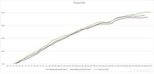

The first chart below shows all runs at the same time, which is pretty messy.
Below that is a dyno chart of stock versus Tune 1. Tune 1 was best overall but Tune 2 and 3 were better at high revs. With the stock tune, the headers made more power than stock in the high end and a bit more down low but were worse through the mid-range. So, the headers definitely need a tune to get the most gains.
I then took the car home and did some data logging for all three Severn tunes at an off-street location that allows a full third gear run. I sent the dyno charts and data logs to Josh, who then developed a couple of fine-tuned maps, resulting in Tune 6. I took the car back to the dyno and ran Tune 6 against the stock tune. In hindsight, it would have been good to also run Tune 1 on the same day but given it takes 50 minutes to load each tune, it just wasn’t feasible. The first dyno chart below is completely stock vs Tune 6 (done nearly a month apart) and the second is comparing stock tune (with headers installed, obviously) and Tune 6 (done on the same day with car kept strapped to the dyno). I was expecting Tune 6 to perform a bit better but when I compared the two stock tune with headers runs (one week apart) as a rough internal control, the readings were down on the second day, perhaps indicating that Tune 6 would have put up better numbers if it was run on the same day as Tunes 1-3. I’m not really sure why that would be but if nothing else it shows that comparing dyno runs from different days is pretty tricky. I didn’t get a dyno print out comparing the SS headers with stock tune over the two different days, but I did enter the data in MS Excel to create a chart (Tune 6 also included for reference). See below.
