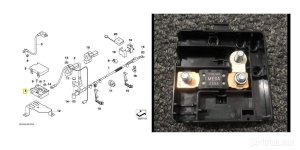

I can't imagine you have blown the main fuse - it's something like 250A, but I guess it's something you can check. It's part 4 in this diagram but unfortunately I'm not exactly sure where it located....
There are also several other large fuses under a cover in the main fusebox behind the glovebox....
...and also some more under the bonnet on the passenger side....
BUT I'd really be quite surprised if they had blown since you haven't really shorted anything out to speak of. Before you do anything it is worth disconnecting the battery one more time and shorting the +ve and -ve battery leads together for 30secs or so. Then reconnect.
