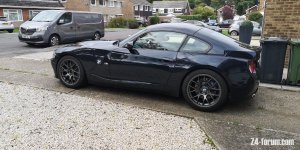

Collection of the car (from my house): Delivery at Redish:
