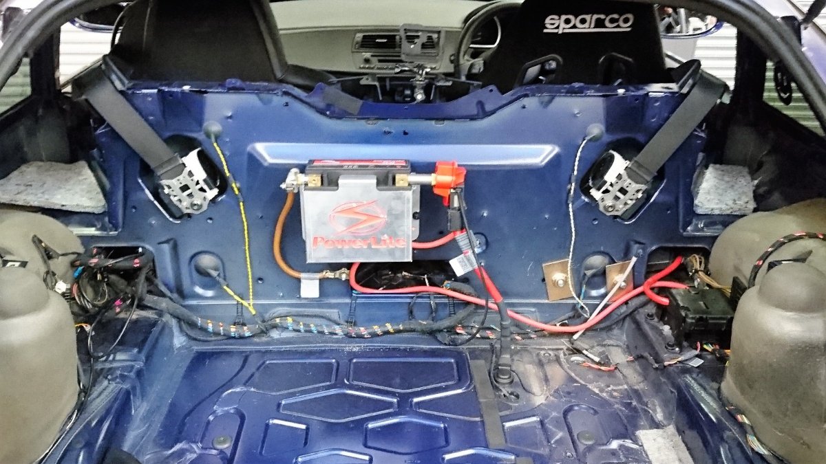

Post by Liam22 » Sun Mar 03, 2019 6:58 pm
Impressive cranking amps! I bought a 480CCA Lithium battery (1kg) but it's not man enough to turn the starter.

Post by TomK » Sun Mar 03, 2019 7:24 pm
Liam22 wrote: Sun Mar 03, 2019 6:58 pm Impressive cranking amps! I bought a 480CCA Lithium battery (1kg) but it's not man enough to turn the starter.
Can recommend one of these. Been running it on the road with my 3.2 for a couple of months so should be fine for yours. 2kgs - 630CCA
https://www.brtmotorsport.co.uk/collect ... et-charger
added bonus is that the bracket fits nicely to the existing fittings for the amp brackets, though maybe you won't want to mount it on the bulkhead for your race car. Hopefully it's slim enough so I should be able to put your 3.0 trim back in to give me a decent shape boot :)

Batt is in.. lol my mate told me, yeah do it now.. 25 minute job... Freaking the whole afternoon.. finished at 7pm.. holy crap.. :thumbsup:
