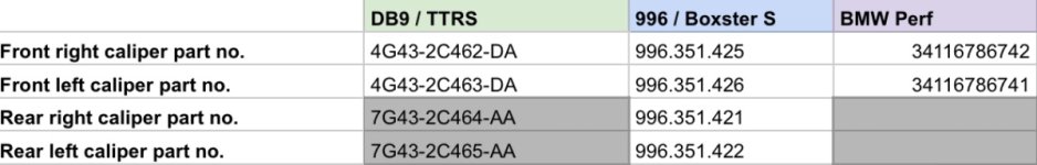

Here are the part numbers of the calipers mentioned above, FYI:
Last two characters of the Aston ones are the colour code.
