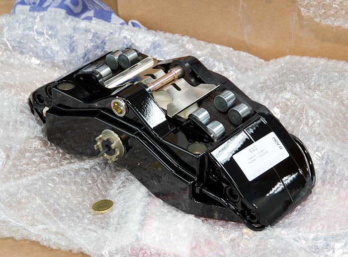

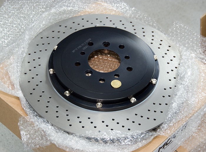

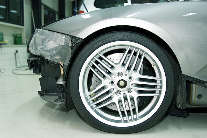

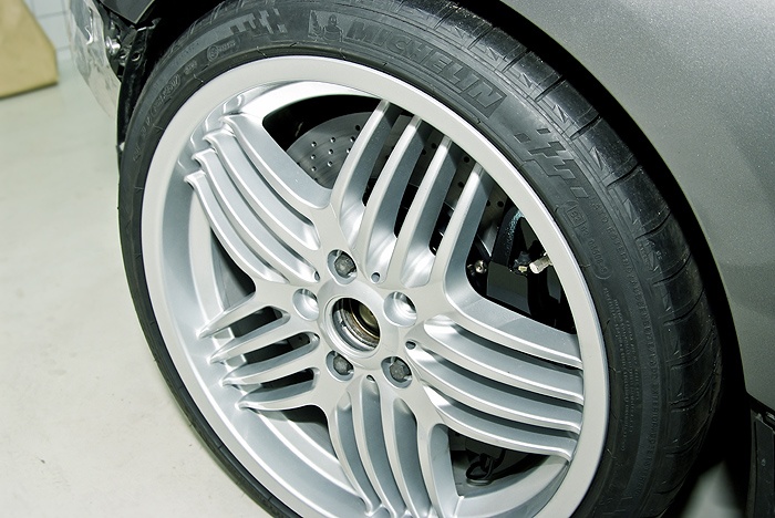

The new Mov'it brakes (380mm discs and 6 piston calipers) are in. Finally some progress on the car is being made. The discs and calipers are huge
. They fill up the front wheels very nicely. It's impossible to fit bigger calipers (or smaller wheels
). There clearance between the calipers and the spokes of the wheel is very tight. The good news is that there will be no need to modify the fenders.

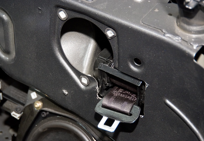

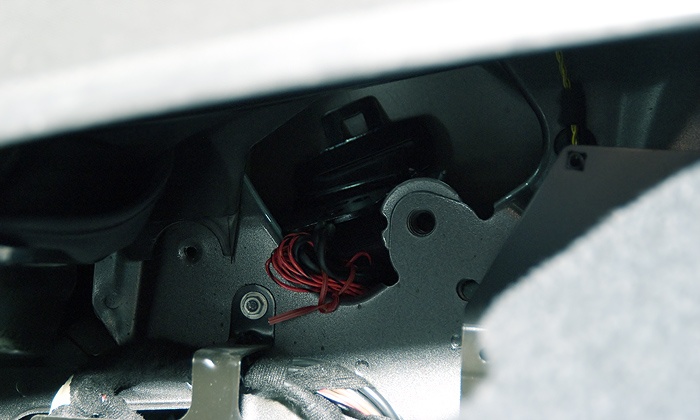

We are also working on a way to fit the Schroth inertia reel in a secure place behind the seats.

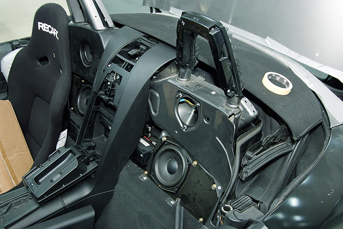

The seat belt inertia reel (don't know a better name for it) is now mounted in place using a brace on the original mounting points. We had to cut a hole near the upper speaker. The seat belts are perfectly aligned to the belt slots in the seats. The 100mm speaker will be replaced by a smaller 3.5" model. We have ordered two frames from a Mercedes which will be used the cover the edges of the hole in the interior panel behind the seats.
The whole top had to be removed the mount the inertia reel.
