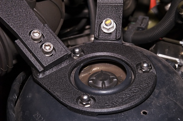

I really enjoy giving a personal touch to my cars. The first mod was a Helene Performance filter, followed by an eOpen eTip module and a Strong Strut strut tower bar.

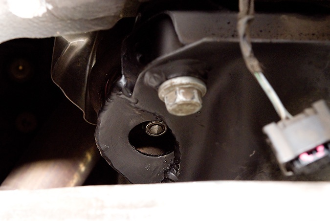

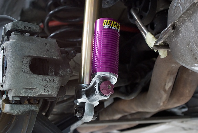

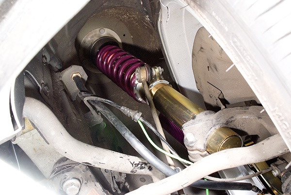

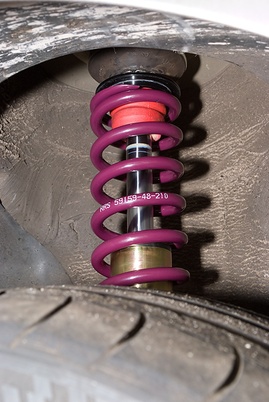

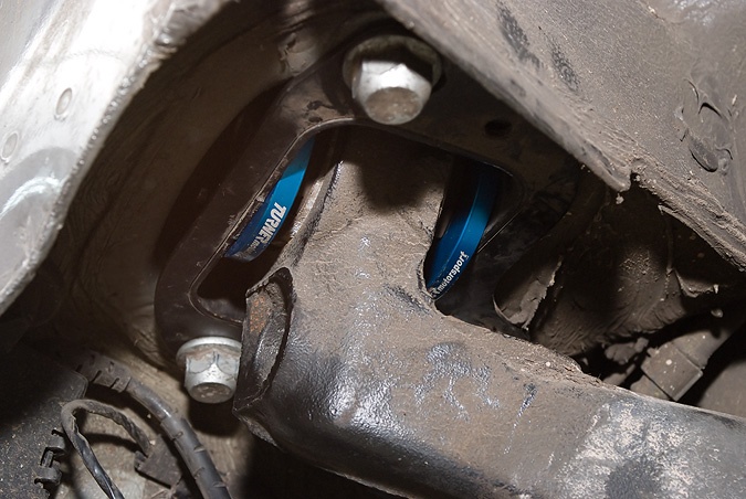

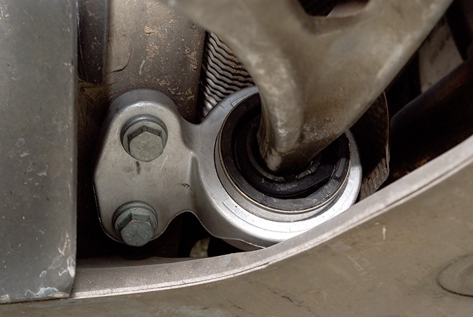

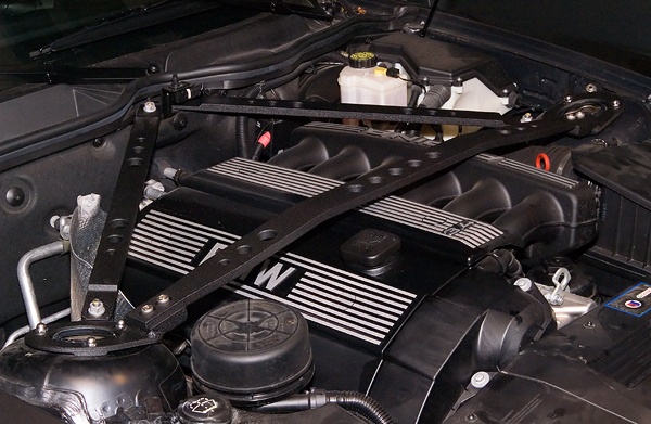

The suspension was uprated with a new front lower arm bushing, rear bushing limiting kit, rear trailing arm bushing and front subframe reinforcement kit, all sourced from Turner Motorsport. The shocks where replaced by high performance units from Reiger Racing Suspension. Reiger is a small company located near my hometown which supplies shock absorbers to several racing teams, including the Ford WRC team, the Chevrolet WTCC team, the BMW X-Raid team and many Dakar teams. Their products are of very high quality.
Front subframe reinforcement:
Front lower arm bushing:

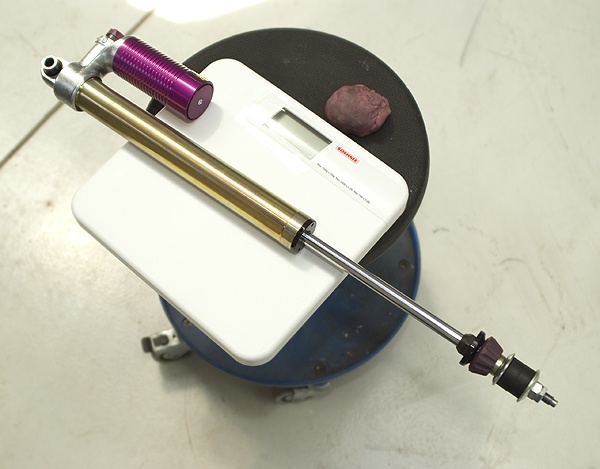

Reiger rear shock:

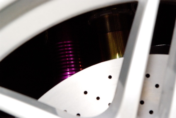

Reiger front coilover:

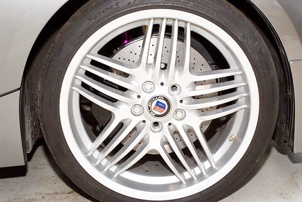

The front brakes have been upgraded by a 4 piston Mov'it big brake kit with 342mm brake discs. The rear brakes have been upgraded with drilled brake discs, Ferodo brake pads and stainless steel brake lines. The fenders will be widened to create space for the BBK. Without modification the front wheels stick out of the body by 7 millimeters.

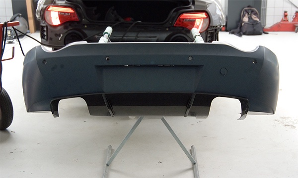

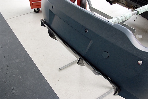

BMW aerokit diffuser:

Very nice!! I like the rear deffuser but it would be nice to see it on the car before I run for my cheque book. In the mean time where can I get one and how much are they? Is it a supplied by BMW? My dealer will blow a fuse trying to locate it. I had to supply them with the part number for my oil filter before he could get me one. Turned out to be an E36 M3 item. :roll:

Curtis wrote:Very nice!! I like the rear deffuser but it would be nice to see it on the car before I run for my cheque book. In the mean time where can I get one and how much are they? Is it a supplied by BMW? My dealer will blow a fuse trying to locate it. I had to supply them with the part number for my oil filter before he could get me one. Turned out to be an E36 M3 item. :roll:
The diffuser is a BMW part. It's listed in the Dutch accessoires brochure, which I think is a direct translation of the original German brochure. For some reason it's not in the online UK brochure. I believe it will only fit the facelift bumper however. There's a diffuser for the pre-facelift Z4 but that one is real ugly.
The part number of the facelift diffuser is 51 71 0 410 384. It's made of carbon fibre and it's very light.

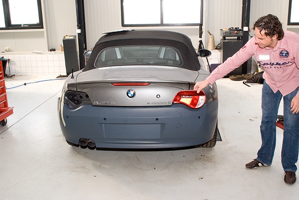

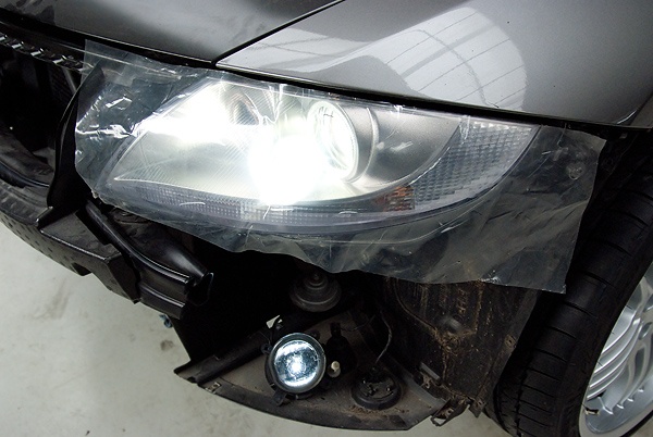

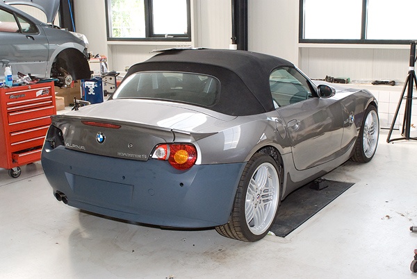

Two months later the car is still in the garage. The headlights were adapted to make them work with the pre facelift light control module. The rear units are partly working. The brake light is lightens together with the rear lights. This should be fixable by reprogramming the light control module. So far there has been no need to change the light controle module to the facelift version.
I've had the door handle LED mod done and the door panels were filled with sound dampening materials to enhance the "tinny" sound when closing the doors.
The front control arm / wishbone was replaced with 330i ZHP ones featuring solid ball joints. I don't know if it's different to the stock control arms. I now have all the suspension enhancements from Turner Motorsport :).
Unfortunately there are still problems with the brakes. To clear to brake caliper the front spacers need to be 7mm wider than originally expected according to the data supplied by Mov'it. The wheels will now be 1,5cm outside the wheel wells which is a lot more troublesome than the 7-8mm we originally had to find a solution for. Mov'it is offering the replace the brakes at no extra cost with bigger ones which should have better clearance. It would take another five weeks to get these parts delivered however :( .
The wheels and the stock brake calipers on the rear axle have been repainted.
Work on the rear bumper, diffuser and exhaust is still in progress.
