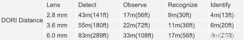

First off, if you want proper CCTV (i.e. not just keeping an eye out for when Amazon arrives) you will want wired. You will also want it to record all the time as motion activation can be temperamental. Storage is cheap (ish) so unless you have 10 cameras you can easily have it record 24/7.
With reasonable resolution cameras they can chew up wifi bandwidth quite quickly too.
In terms of what camera to get the lens is important (much more important than megapixels!). Here is a guide:
Also worth doing research on which cameras are better at night. Dahua Starlight cameras for example are so good in low light that providing there is a small amount of ambient light they stay in colour mode at night time. This would be useful if you wanted to see the colour of the intruders jacket etc.
I went the home brew method, using Blue Iris software on an old Dell PC (desktop PC's with newer processors work much better than servers for CCTV!). Threw in an 8TB Hard Drive and it works really well with 6 cameras.

That’s the other thing I’m not sure about is the lens, 2.8 being wide angle I read that that the person has to be quite close to be seen properly?sp3ctre wrote: ↑Fri Apr 30, 2021 11:56 am First off, if you want proper CCTV (i.e. not just keeping an eye out for when Amazon arrives) you will want wired. You will also want it to record all the time as motion activation can be temperamental. Storage is cheap (ish) so unless you have 10 cameras you can easily have it record 24/7.
Booked the company to come and look, but not till early June when I can be home in the day.
Blue Iris though needs a pc (cheaper then nvr) but doesn’t that just put all the cameras on the main network then, with bandwidth concerns?
