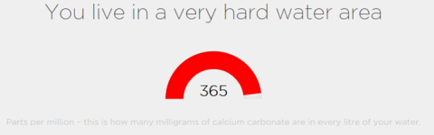

The old tank was a bu99er to get down stairs because of the weight so in an idle moment this afternoon I cut the top of - well what a shocker! I keep posting about how hard the water is in our area
but this was a surprise - half the tank full of scale its a wonder I had any hot water at all. It weighed in a 44kg (in a 900 x 450 tank) and I've not knocked it out of the dome yet?

Thanks for sharing. I shall be showing this to 'management' to explain why I keep putting Calgon in the washing machine!
Maybe then she'll appreciate the 'scale' of the problem.
No wonder washing cars here is a nightmare; leave it 5 minutes before you dry it and the paintwork is covered i white spots!
