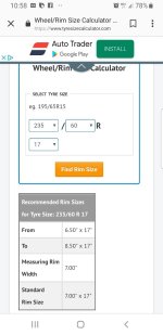

Thanks for the link road warrior. I put in my sizes and the rim width is okay
- Screenshot_20190315-105822_Chrome.jpg (64.75 KiB) Viewed 605 times
