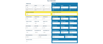

I have some new alloy wheels which are 8.5j front and 9.5j rear, fronts have 225/40/18 tyres fitted on the front currently but they look slightly stretched, will fitting 235/40/18 fit without affecting speedo too much and look more square on the wheel?
according to a tyre calculator see the pic,
thanks!
thanks!
- Screenshot_2020-06-03 Tyre Size Calculator Tyremen.png (66.48 KiB) Viewed 819 times

Hi,
It wont affect the speedo at all as that's done from one of the rear wheels. It will look squarer/less stretched although I personally don't think 225/40 on a 8.5" looks bad at all, I have it on mine
