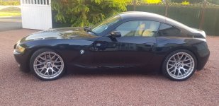

I’m running 1M 359’s on my MC
Front Wheels - 19x9" ET31
Rear Wheels - 19x10 ET25
Front Tyre - 245/35/19
Rear Tyre - 275/35/19 (usually 265)
Slight rub on the OS liner on full left lock in reverse. Lowered front and rear (unsure how much)
