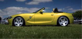

Post by Joycey » Mon Jan 29, 2018 8:58 am
These wont rub. Gaz has them on his z4.
