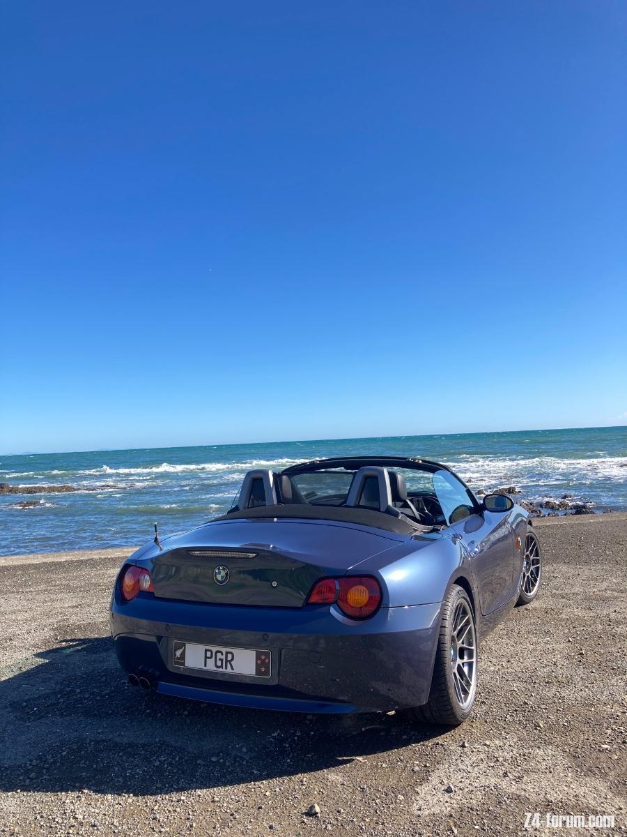

I prefer the hyper black which I have over the bronze, just my personal taste. I am in the opposite position to you, have the wheels and about to fit eibachs. As I mentioned, the rear should be fine on eibachs. I am concerned about the front. The Michelin ps4’s sidewall seems a bit more square than some other brands of tyres. I had 235 x 40 x 18 on the front but had to change to the 225’s as there was slight rubbing on compression and slight left lock.steve_naive wrote: Thu Jun 10, 2021 2:14 pmThanks for the info. Apex say their 8.5j et35 or 38 are a direct fit. I'm a bit concerned about the slight drop provided by the Eibachs.Haggisman wrote: Thu Jun 10, 2021 10:55 amMeant say that rear tyres are 255 x 35 x 18 and wheels happen to be Hyper Black, great wheels.Haggisman wrote: Thu Jun 10, 2021 10:53 am
I have the same model Z and fitted Apex arcs front 8.5 x 18 et 38 with 225 x 40’s. Rear is 9.5 x 18 et 35. PS4’s all round. Currently on standard suspension and clearance at rear is fine but marginal on front, very occasional rubbing on outside inner arch near the front bumper under aggressive compression. Have a set of eibachs and koni’s about to be fitted, car is just too high at rear and needs to be a bit lower at front, will need a bit more neg camber at front to stop rubbing I suspect.
I think Hyper Black would look great with my sterling grey. They even do a bronze, which would be very cool. Waiting on a restock though.
Typical.
Do you have any pics?

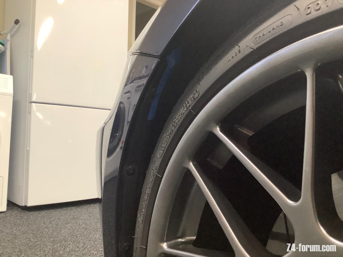

Having said the above, the front ride height of my car is lower than it should be on factory standard suspension (non sport). The rear is where it should be. So, not sure why it is that way so I’ll try the Eibachs and see where the height ends up. I actually have a set of H & R springs but they lower the front even more than the eibachs so bought the eibachs. I see they have discontinued the Eibachs for this model of Z4.
As Mr Wilks has said previously, it can often be only millimetres that make a difference and that is what I believe in this case so a bit more negative camber (currently standard spec) should work. Also, new tyres with lots of tread can make a difference. Will be interesting for us to compare notes.

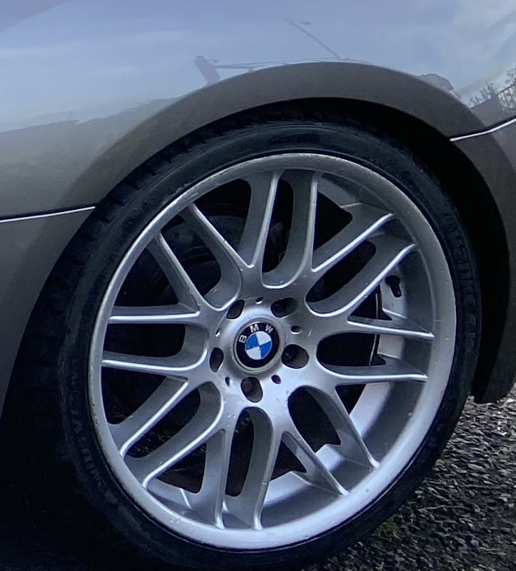

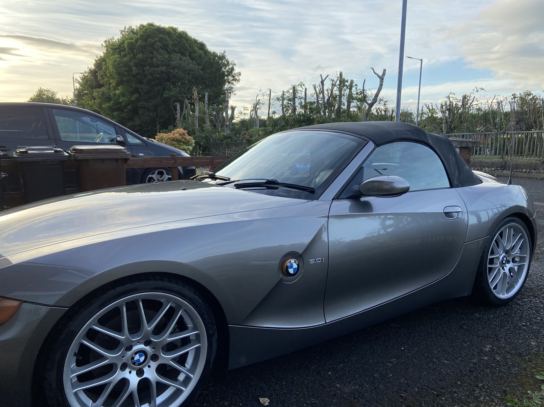

These are my 19’s on eibachs, could be still settling:
Terrible angle but here’s the rear:
Car passed MOT so am looking to order the Arc 8’s now. The 19’s are fine but look a bit big to me. Maybe if they were darker I could live with them.

Interesting, not as low as I thought, in one of the pictures you should see some blue tape on the inside liner where the 235 profile tyres were rubbing, 225’s seem fine. Personally I think the hyper black or even anthracite apex will look great on your car. Cheers.steve_naive wrote: Fri Jun 11, 2021 10:15 pm These are my 19’s on eibachs, could be still settling:
