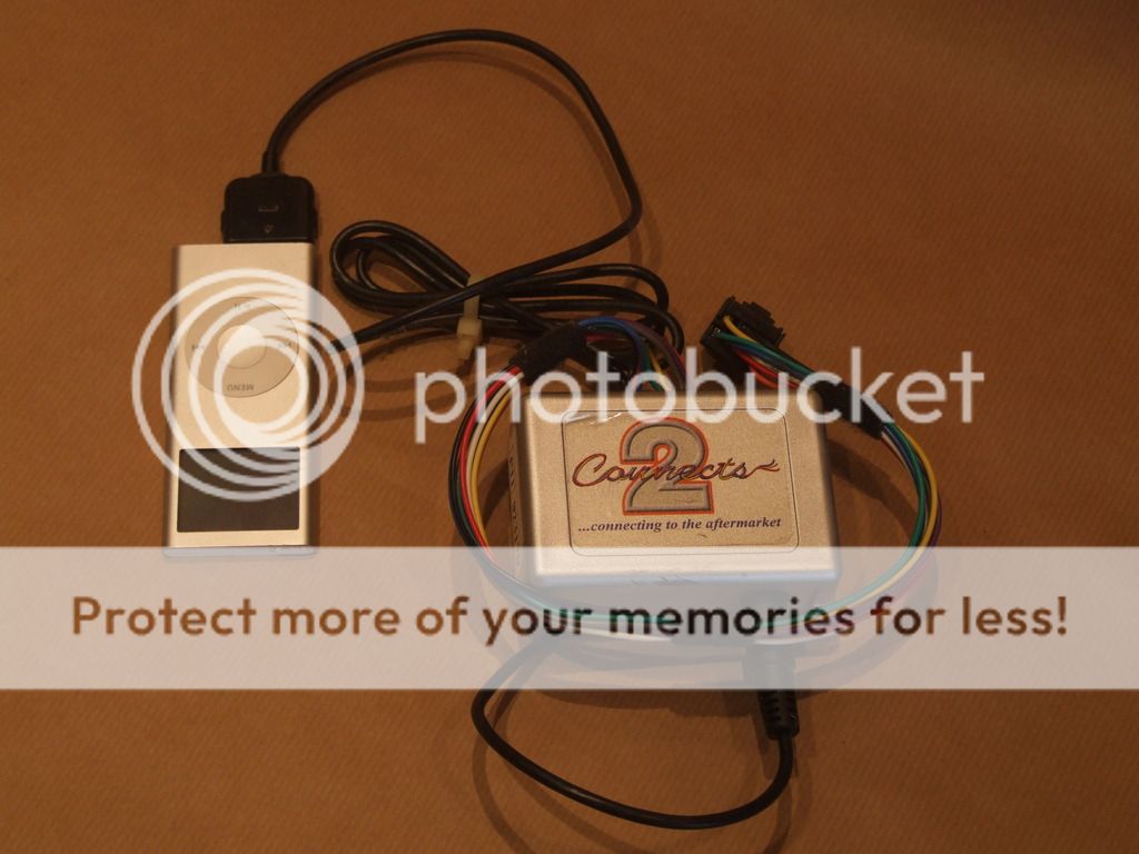

About ten years ago I fitted my ipod to the ford radio in my Puma using the box in the photo to access the playlists and provide power. I just cable tied the box and the ipod to the bulkhead behind the dash board and forgot about it.
Yes I know that this box won’t work in the Z4. However this set would appear to be a simple solution – I’ve read that UK cars have a lead fitted from the radio head to the CD changer so I just find the end of the lead in the boot; then cable tie the ipod and box against the rear bulkhead from inside the boot.

If you don't have navigation then go for the intravee. There are one or two other options which all work in a similar way.
The lead you want can be retrieved through the boot by lifting up the carpet on the firewall. Then through the hike in the middle the two plugs are usually found tapped to the floor or storage bin.
