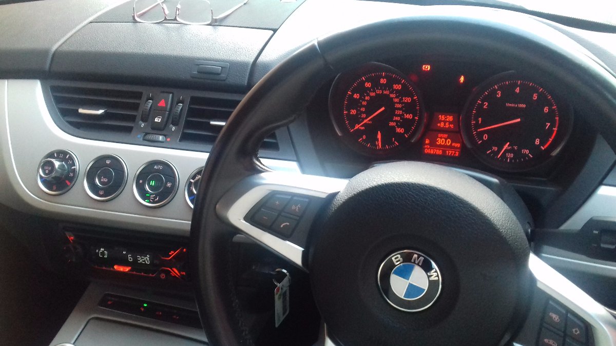

I have fitted a Pioneer amp and Focal speakers to mine but only had the base speaker set up with no amp. If you have an amplifier fitted it will be behind the bulkhead panel in the boot on the drivers side. Remove the panel and have a look. That's where I fitted my amp. I repaced the professional unit with a Sony unit but took it back out as it didn't sound any better so no point in buying Connects 2 interface wiring.
