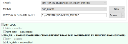

update, forgot to add
as a final step, the software-based Diff Lock option to be turned off using NCS Expert in the DSC module
Engine Power Reduction was already "off", but saw it "on" for some other models
Screen Shot 05-28-20 at 05.35 PM.PNG (35.41 KiB) Viewed 173 times
