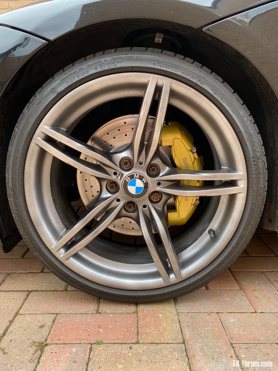

Big day today.. having the front OEM brake upgrade fitted to my 23i by Bartlett’s in Huntingdon, Cambs. This is the …738 part specific for the 330i (I believe) which has been recommended here (and elsewhere) for the Z4. I’ll add some pictures when I get it back later, all things being well.

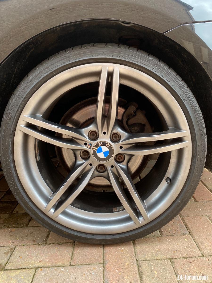

So I will attach a ‘before’ and ‘after’ shot… albeit the ‘before’ is the current rear but you’ll get the point as to why I’ve done this (front was similarly ‘industrial’ looking and a corroded disc. The …738 kit went in a dream I’m told.
There is a little troubled news, which is the courtesy health check has identified both rear alloys are cracked. Something to ponder now as to options, but that’s not for this topic.
Anyway, extremely happy with the new look - they look more impressive than the pics do justice - and will undoubtedly add to braking performance especially as my Z4 is an auto. Rears will be colour matched in a few weeks… A

I'm biased of course but I like the OE look of the kit :thumbsup:
As I said you can toggle and even tweak the DCS s/w settings to set the 'feel up'

jenniferlouise wrote: Thu Jun 17, 2021 3:51 pm Anyway, extremely happy with the new look
they do look lovely. :thumbsup: I must get mine painted...
