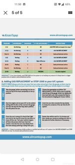

150psi sounds very high. Here's the chart that I use when filling my old MX5 with the kits you buy on line
