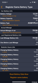

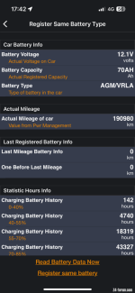

Before:
After:
Can you provide a hardcopy of your counters?
Tried again read battery with ignition off , turned ignition on (No engine running) registered battery and it worked. re read battery and counters are now at zero with current mileage as below. thanks for your help.

Interesting, that you'll get displayed the unit "kilometers". I assume, it should be "miles" and is a bug of the software, isn't it?

Yeah think it was the read with ignition off then ignition on to register that made the difference for some reason.
And not sure why the reading is KM but all sorted now cheers.
