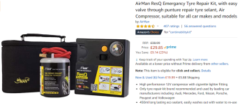

Thanks guys for all the advice. I have just ordered 4 x Michelin Pilot Sport 4 (non runflat), to be fitted on Wed. And you are right, I care much more about not aquaplaning into a tree when the road is slippery, than about dealing with a hypothetical puncture.
I will add a 12V tyre inflator, that's actually great advice, didn't think that was an option.
- enuff_zed
- Posts: 14758
E89 rear slippery on wet country roads - Best solution ? Tyres ?
I got one of these for mine, following recommendations on the forum.
Good price, and can be used as a standard inflator too.
