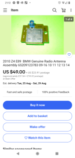

My broken part no: 65209123783
Some of US eBay...
Some of US eBay...
- Screenshot_20200813-211217.png (268 KiB) Viewed 991 times
2016 GPS Antenna Failure
"wiring harness" is a standard cable with a fakra connector. Ideally you can just replace the broken antenna onto the existing cables or you need to start taking the car apart

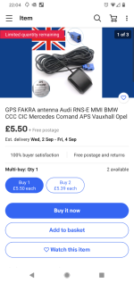

If you're going to have to tear apart to fit new wiring then something from eBay for $10 would do the trick. Every time I search .com it sends me to the UK site annoyingly, but you're looking for something like this...
- Screenshot_20200813-220419.png (217.26 KiB) Viewed 982 times
First things first, order one of the above, pull out the idrive unit and plug it into the back. Make sure the reciever has a clear view of the sky and give it a few mins and see if it picks up a signal.
For a few dollars you can quickly check it fixes the problem.
If so then you can go ahead and rewire through your car but if not you can try other stuff without having gone through the pain or doing all the trim etc

Good point on plugging it into the back of the unit directly first...
Does this cable terminate in the head unit that's lower down by the ashtray, or the CIC unit (display, just in case Im using the wrong terms) that's up in the top? Can you confirm that the termination on that is correct (gender, keying, etc)? I did some digging on Fakra connectors and they have different physical keys available. I believe the antenna side had a single tab at the top of the connector.
Sorry for all the questions... At the end of the day I can always just start pulling stuff, but sure would be nice to be able to buy the part and have it in hand before I do that.
Not so hot on the names myself, but it goes into the back of the unit down by the ashtray, not into the screen itself.
I can't recall now but I believe it was pretty easy. Trim off and 4 acrews. Once you've got it out you can't miss it. I don't have the car anymore so can't help with gender etc at the moment

No worries man, you've already been a massive help. I know (from having seen video) exactly how to get that piece out, and you are correct. Not that bad. BIT more work to properly embed the entire wire once its in, but for a quick test no sweat. Sweet. OK I already told the dealer no thanks. I will pull the head unit tonight to verify connection, then buy a replacement. Should be able to install this weekend and put this mess behind me!
