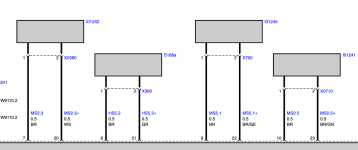

- tintoverano
- Posts: 666
- Joined: Wed Jan 09, 2019 4:33 pm
Odd roof error warning
it may be related to broken wires
you could try using the signal of the working side of roof shell 2 to see what happens
pin #20 and #23 play part here
in your case the right side is closed (X0710, pin #23), but not the left side pin #20 - see what happens, if you switched them or use the signal from pin #23 in pin #20
you'll find these pins in the back of the A96a connector in the CTM

I'm guessing too

the link to the CTM wiring diagram

Thanks Smart bear/Tintoverano, appreciate your time and effort
Very timely info as I'd just got back to the garage.
Showed it to the owner, however the guy is convinced it's not a broken wire, so I didn't want to push it
He linked the car up again to show me the MS/sensor read outs. Must have been a dozen or more
All the readouts were correct (Open/closed)
He then opened and closed the roof and as I watched the open/closed readouts changed - all as to be expected
Roof had been up and down all morning with no issues
Then he told me he had watched a 'real time trace of the micro-switch on a drive up the road earlier.
Got to over 30 mph and got the dash warning/bong. Immediately the trace was reporting the micro-switch was open, code A68B & A697
He thinks it's a faulty control module somewhere or possibly a software issue
His suggestion is to at least let BMW run their diagnostics over it
Thanks again guys
