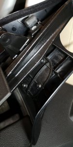

how to remove the plastic cover?
those torx screws are below the linkage

just had to find where to stop the rooftintoverano wrote: ↑Sun Feb 23, 2020 5:47 pm how to remove the plastic cover?

whoa whoa
adjusting the rubber space buffers worked https://www.newtis.info/tisv2/a/en/e89- ... e/AfKTvqOq
I had the noise coming from behind the passenger seat on the right side, so raised those two buffers - lower: ~1.5mm, upper: ~1mm
what a relief this test drive was
thanks for pointers Rob
