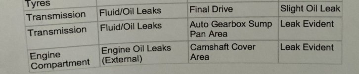

Oil Pan
Hi so basically had the RAC looked and they have reported Final drive slight leak, Auto-gearbox leak evident and Camshaft area leak evident, he did comment that he could not properly see the leaks and the are would need to be wiped down to pinpoint where the oil is coming from so an idea of associated costs would help

Oil Pan
Leak or weep ? Id be wary of throwing vast sums of money chasing "problems" that aren't
If you have a trusted indy then run the car in for a looking at , take their opinion on board & proceed from there , if you haven't a decent indy then ask on here for recommendations in your area

Oil Pan
This is what the RAC reportedmr wilks wrote: ↑Sat May 25, 2019 2:18 pm Leak or weep ? Id be wary of throwing vast sums of money chasing "problems" that aren't

Oil Pan
Surprisingly high ones. The cam cover gasket replacement takes longer than you'd think and the (DCT gearbox) sump gasket usually includes replacement of the sump plate, too.
Phone the garage that's going to do the work.

Oil Pan
I was told by my Indy garage that the dct gearbox sump gasket comes as a kit which I think includes gasket, new sump cover and the oil.
He said the kit is £200 on its own, didn't give me price on fitting as it was just a passing comment.

Oil Pan
My 23i engine sump gasket was leaking slightly at the rear end.
Gasket was over £100 and eventually the mechanic said lets just try tightening it up, I believe the gasket is rubber..
That was over a year ago, no more leaks.
You will also need to replace all the aluminium bolts securing the sump, they are single use.
I was quoted £250 inc parts for the work, it means dropping the front subframe.
The cam cover gasket is important to get done, if the oil gets anywhere near your belts they will slip and likely dismount the pulleys and cause damage or a walk home.
Either way an oil soaked belt needs replacing anyway.

Oil Pan
Thanks for all the information B for BMW in Clydebank quoted £300 for parts and labour
