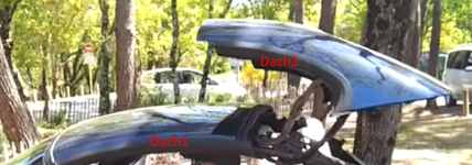

Before I started, some info - Dach1 is the main roof shell, that dock into front, Dach2 is the secondary roof shell, with heated window in the back:

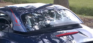

Below is my short analysis of the weak points (where cable bends to much) in roof construction:
1) movement of Dach2 - the red "ovals" pinpoint the weak points. These bending points cause cable to bend over 160 degrees
a) Dach2 is stowed on Dach1
b) Dach2 is in on transition to closed position (on the back lid)
c) The transition of Dach2 is completed and Dach2 is stowed on back lid.
2) movement of the whole pack (Dach2 and Dach1) into the boot section.
The following photos are from this section:
a) Dach2 is stowed on Dach1 - both in upper position - view from inner side of hinge
b) Dach2 is stowed on Dach1 - both in lower position (stowed in the boot) - view from inner side of hinge

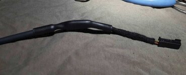

Update: I replaced 3 pair of wires today: to microswitch left, right and to hall sensor (all in Dach2)
Wires were connected by using "Western Union" splice then clenched using small metal tube. Both wires were isolated by tape then isolated from environment using temp. shrinking tubes with glue.
Left side:
Right side:
Left side:
Right side:
