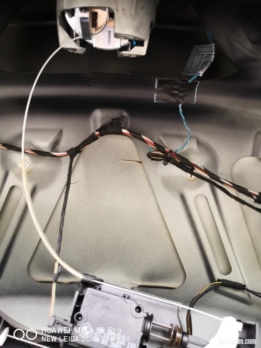

... or apply the bowden cable found in US versions, there are related posts here

true, I did modify that a bit, and led the cable out where it can be reached from outside of the car

tintoverano wrote: Thu Jul 15, 2021 7:53 am true, I did modify that a bit, and led the cable out where it can be reached from outside of the car
Can you enlighten others as to what you did? I've only had my car 8 months, and the stories on this forum are scaring me.

take a standard bicycle brake bowden cable
hook it in to the prepared place
and lead it out via the roundel, one needs to make a few holes
cut and feed the end of the cable end into the middle of the roundel
