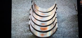

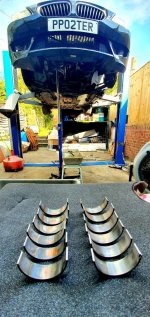

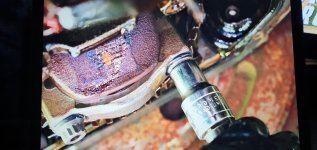

I won’t go anywhere else for this type of work again. Happy to share any more details if anyone interested but in a nutshell, car at 56k 3 owners including me, just had an inspection 2 before this, all was well, however as you can see from the pictures the bearings were badly worn, Vanos rattle was audible, although I didn't know that is wasn’t normal as I’m new to the car, now a completely different animal.
Car had full service history from new, Just goes to show if you’re buying a 13 year old car you never know if the car has been driven cold or not taken care of, or even if it has... this could catch you out. Glad I took the plunge and got the work done.
