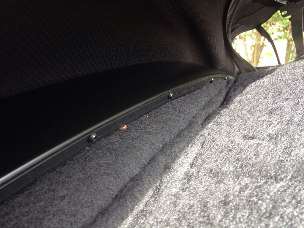

So just a small " How to" on a problem I noticed with my Z's head lining
I notice the head lining wasn't complete uniformly taught across the inside of the roof when the roof was up and viewed from sitting inside the car, there appeared to be a small section that was lower than the rest. For me this was just above the drives seat, but apparently it can happen anywhere across the head lining.
Ok so I decided to take a look and see what was what. I managaed to get my local stealer to send me via email a parts diagram of the roof and found out how the head lining could be accessed to the point I needed. ........

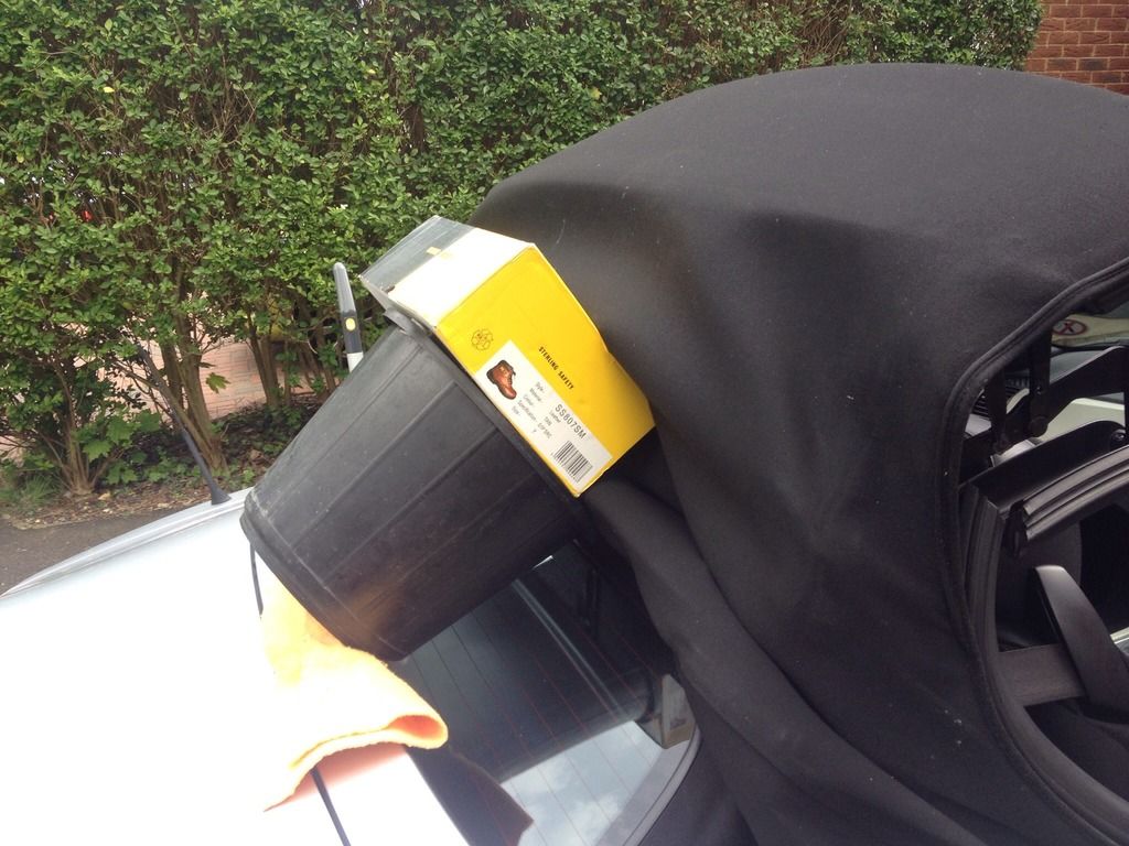

So first you need open the roof and then stop it mid way so the roofs plastic front inner section is above the head rests or there abouts.
then chock it with something suitable to stop it rolling back down

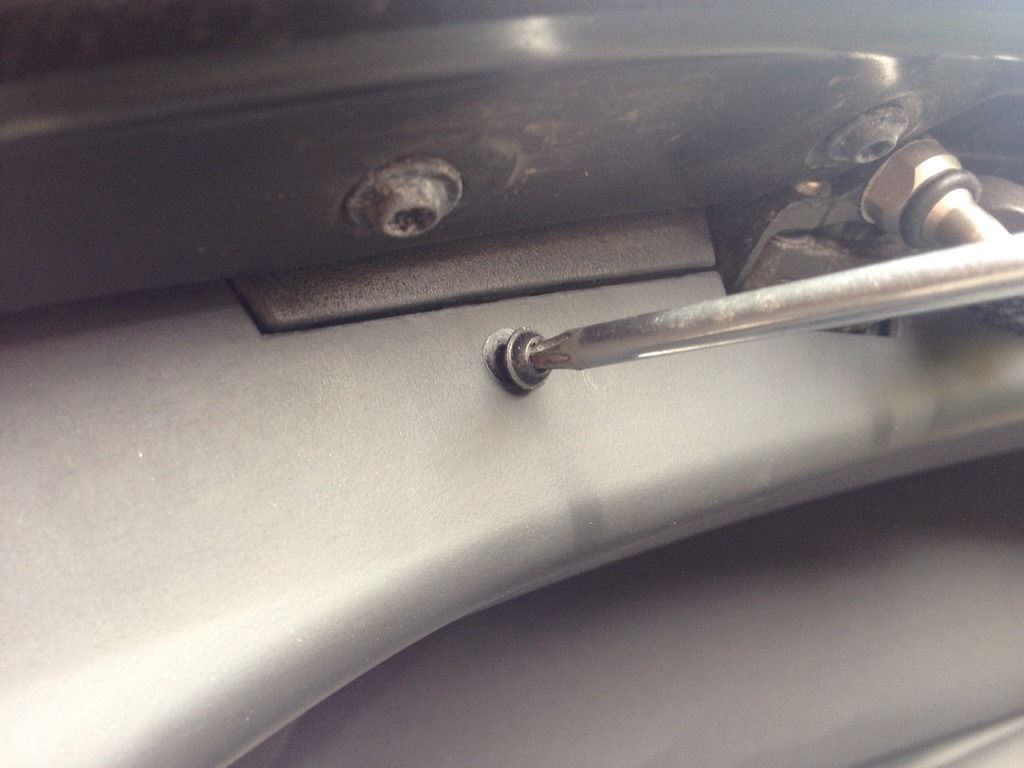

remove the locking mechanism motor cover, this just unclips/pulls off with a gentle tug
inside this cover is a small T20 Torx screw that needs removing
Next remove from either side another T20 Torx screw , counter sunk this time, hidden just at the back and to the side of the inner plastic locking mechanism cover
finally remove the 4 x T20 Torx screws along the front edge of the plastic locking mechanism cover
Now just ease to cover and attached lining down onto the top of the headrests and roll hoops

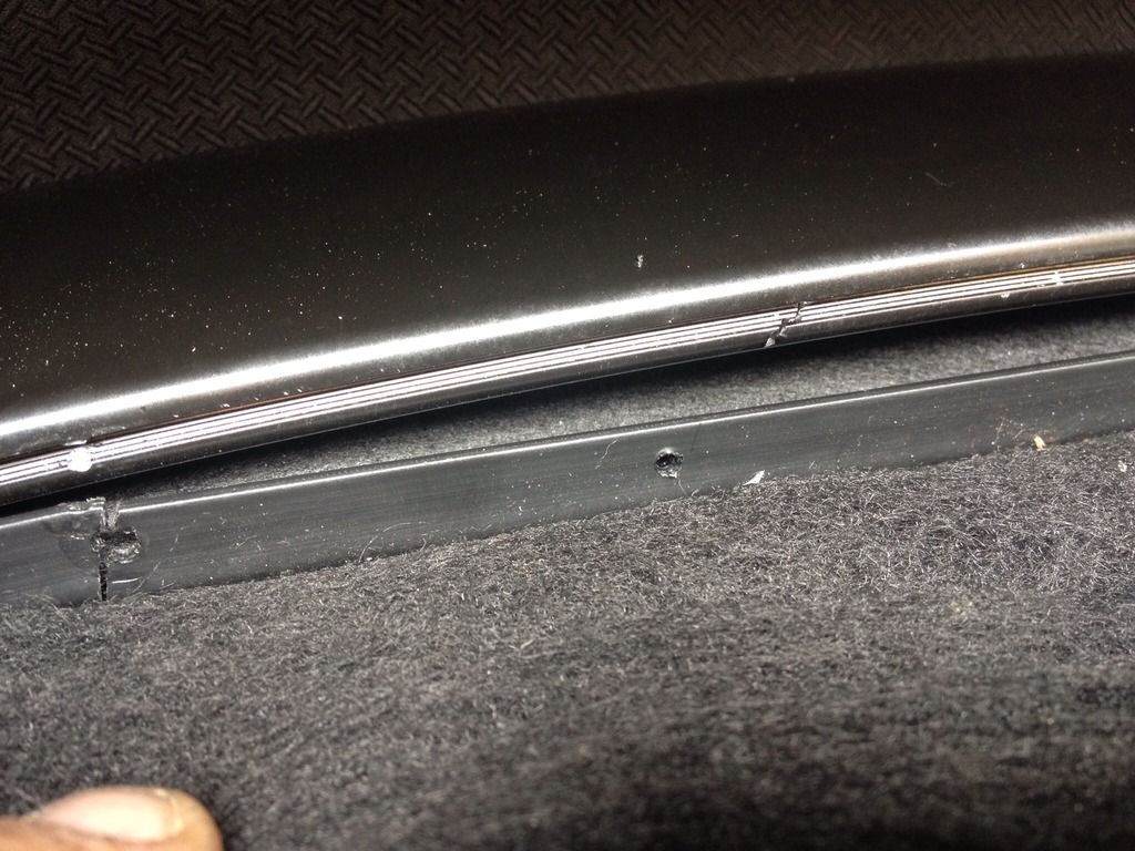

now you will see the problem ........a thin plastic strip that is sewn into the liner screws to the roof frame, and this plastic strip cracks over time and come away from the fixings.
What I did was remove any fixing that weren't doing anything and drilled some new holes in the good section of the plastic lip and screwed the fixings back in. The frame has a tapered V section all the way across the fixing bar so you only need to drill holes in the plastic lip as the screws will screw in anywhere along the bar without the need to drill it. Just take care to only drill the plastic, as doing this in situ could lead to potentially slipping with the drill and we don't want any holes on the roof fabric do we !
I tried to drill the holes central to the plastic lip to give better strength , but when refixing with the screws you will need to push up from underneath the liner to get the screw into the V in the bar.

I especially liked the picture for -
"then chock it with something suitable to stop it rolling back down"
:rofl:

i tried a bucket, then changed it to the slightly more sophisticated option.... a shoe box sideways haha
few pics here if its of any help to anybody else, but tbh follow the above is perfect and u cant go wrong :D
