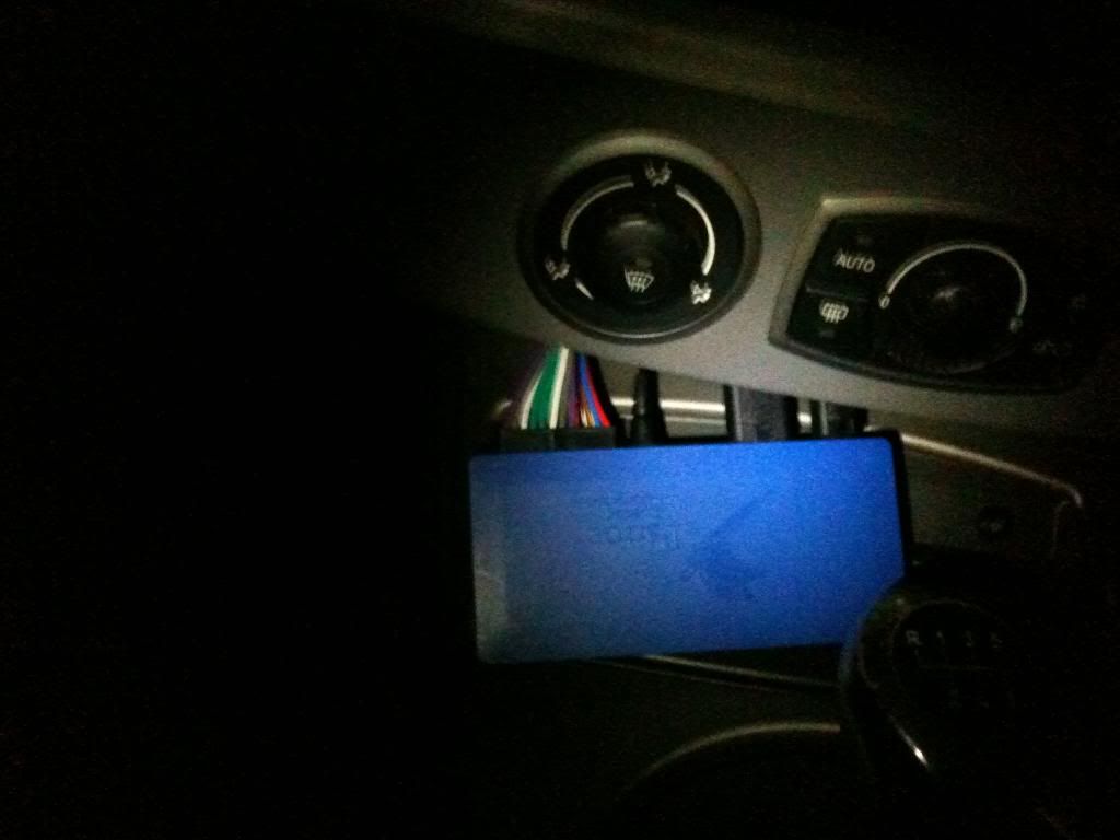

Step 4. Installing the Parrot bluebox, screen, microphone and aux cables
a) The first thing i had to do was find a position for the blue box, i decided the best spot was inside the lower dash panel
