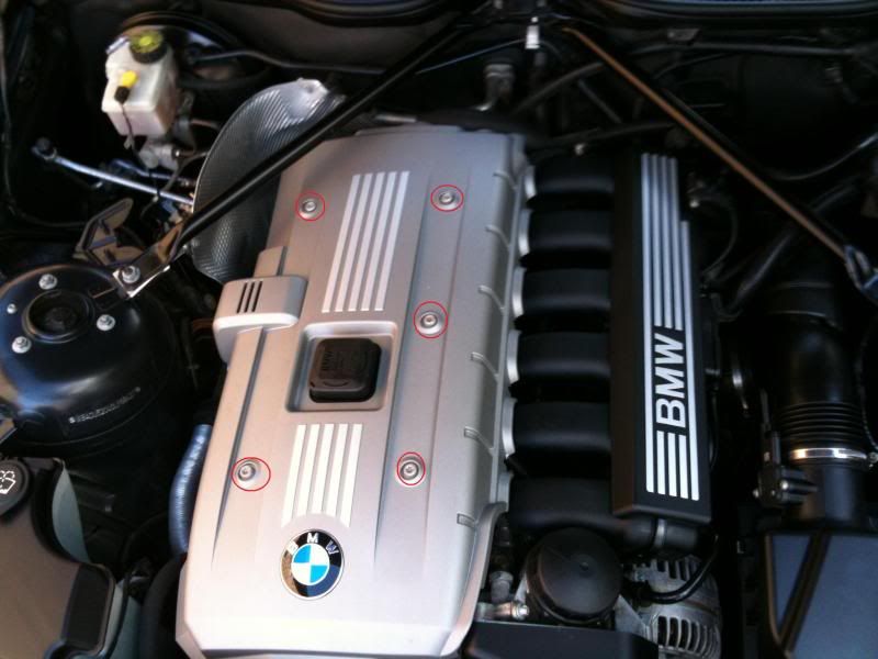

Remove the plastic cover. The 5 'screws' holding it in place (circled red) can be undone by using a flat head screwdriver as they are only held in place by a half turn.

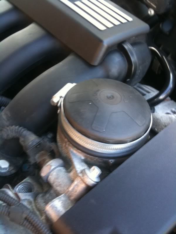

Whilst all the oil is draining (should be quite thin and warm having ran the car for 5 minutes prior) you can remove the oil filter cover. If you have a tool for this (available on fleabay for about £10) then fantastic. If not, it is not the end of the world as I used a large metal jubilee clip fastened tight (so as not to round the edges of the housing) and carefully tighten it, turn it, loosen it and repeat until it was able to be span by hand
Step 4
Remove the old oil filter by pulling it from the cap. Now, open your new oil filter. In the box should be a large rubber seal, a small rubber seal and a washer. Keep the washer safe you will need it in a minute or so but you do not need it now. You need to replace the large rubber seal on the housing (pictured below). The smaller seal goes on the tip of the housing. Put the new filter on, and refit to the car (opposite of removal!)

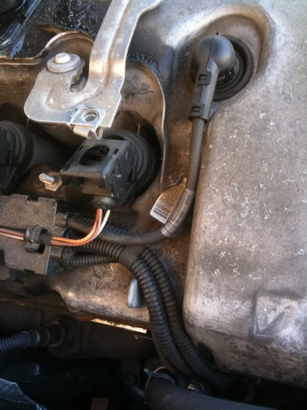

Loosen each of the plug clips and remove the clip with the wires on. DO NOT remove the actual wires. The job is made easier as you can see straight down and use a Flat head screwdriver to pry them apart
Step 7
Give the plug a wiggle and a pull and it should come out. At this point it gives you access to the spark plug. Remove and replace with new one. Put the rubber coil plug back in and reattach the plug you have just removed (the one with the wires on). I did one spark plug at a time so as not to confuse myself with what went where.
