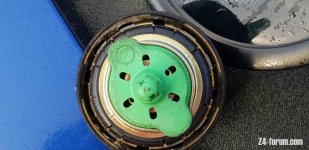

Will a cracked rubber seal on the fuel filler cap give a air leak great enough to give a vacuum leak.
I currently cant find any cracks on my hoses.
my best action may be a smoke test to find it.

Here's a photo of the afore mentioned petrol cap..
- 20210928_182340.jpg (163.24 KiB) Viewed 269 times
