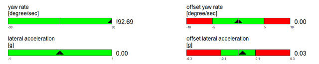

So today was a great day, got home from work and the second hand unit arrived during that day. So after some minor engine work. (Discovered the air intake boot had a massive hole in it, so replaced it with a new unit) I plugged the 2nd hand DSC unit in the car... poof!! No more lights on the dashboard!! ABS, Brakes, everything just fine!!
Fired INPA back up, checked for errors and for now, no errors showing relating to the unit. Now I need to take the car out for a quick drive and give it a go to see if the brakes all function as expected, but I don't see why not. Just really happy the issue is resolved.
