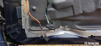

Well I have found where the water is coming in
- IMG_20210807_103958.jpg (105.94 KiB) Viewed 319 times

That looks to be a dodgy door membrane. Take the door panel off and check the membrane

I finally had time to look at this properly, Weston Matt was right it was the door membrane. The black sticky stuck was not so sticky at the bottom.
As the membrane was in good condition I resealed it with silicone. To then over engineer the solution I sealant the bottom edge with aluminium tape.
Thanks for the advice all, just the carpet to fully dry out now
- IMG_20210823_160737.jpg (131.71 KiB) Viewed 200 times
