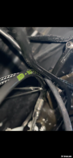

I had this when I relocated my motor, turned out I pinched one of the hydraulic lines. I videoed in the cavity while opening the roof…. Was an easy fix luckily

I'll get a camera on it later on then, let's hope I get lucky. Have my doubts though! The damn thing has fought me every step of the way doing this job...

I was the same with mine… I put a wee socket in the micro switch and videoed from boot using remote to open roof. Hope it’s just the same hose that went on mine…
